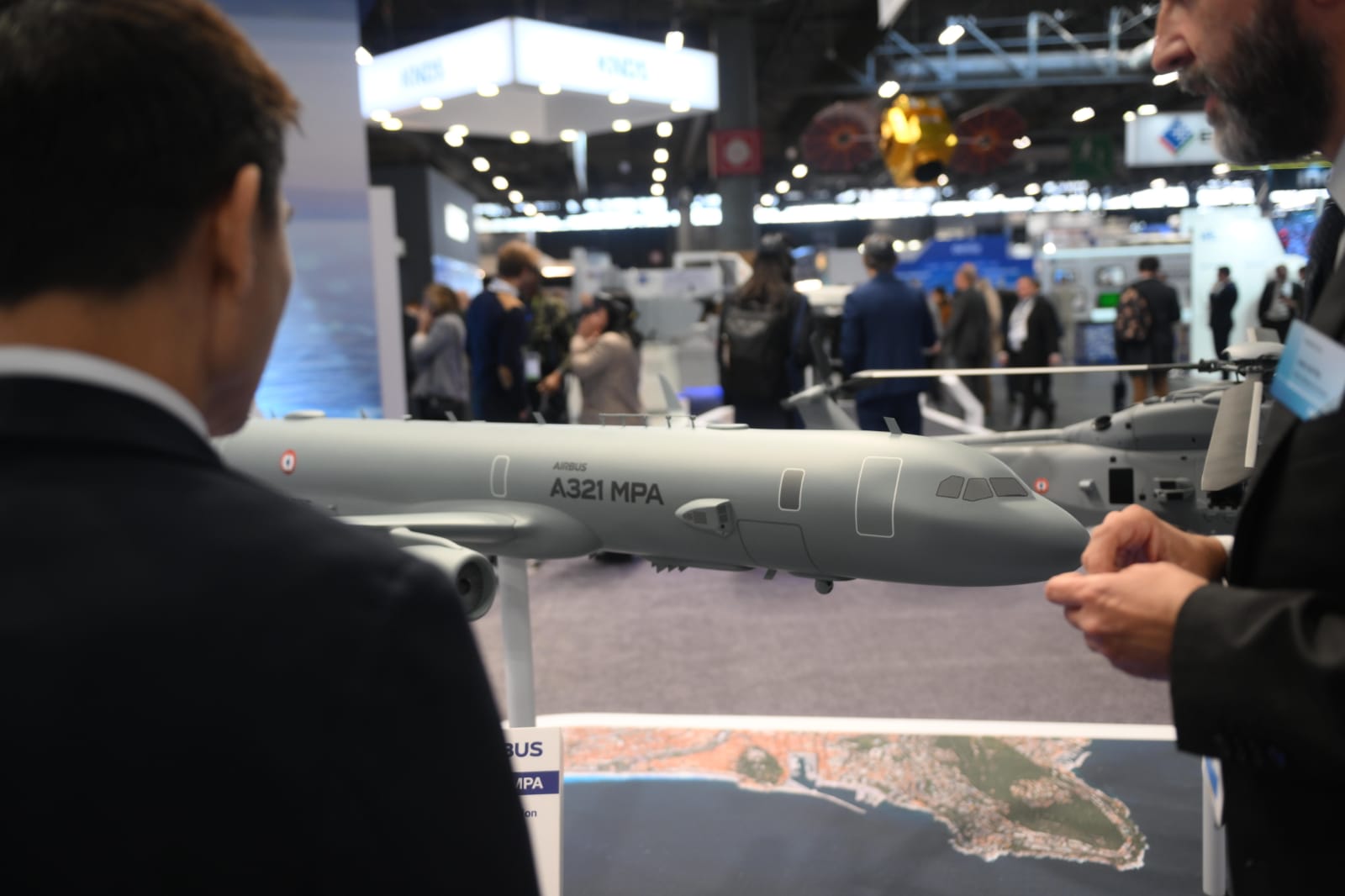

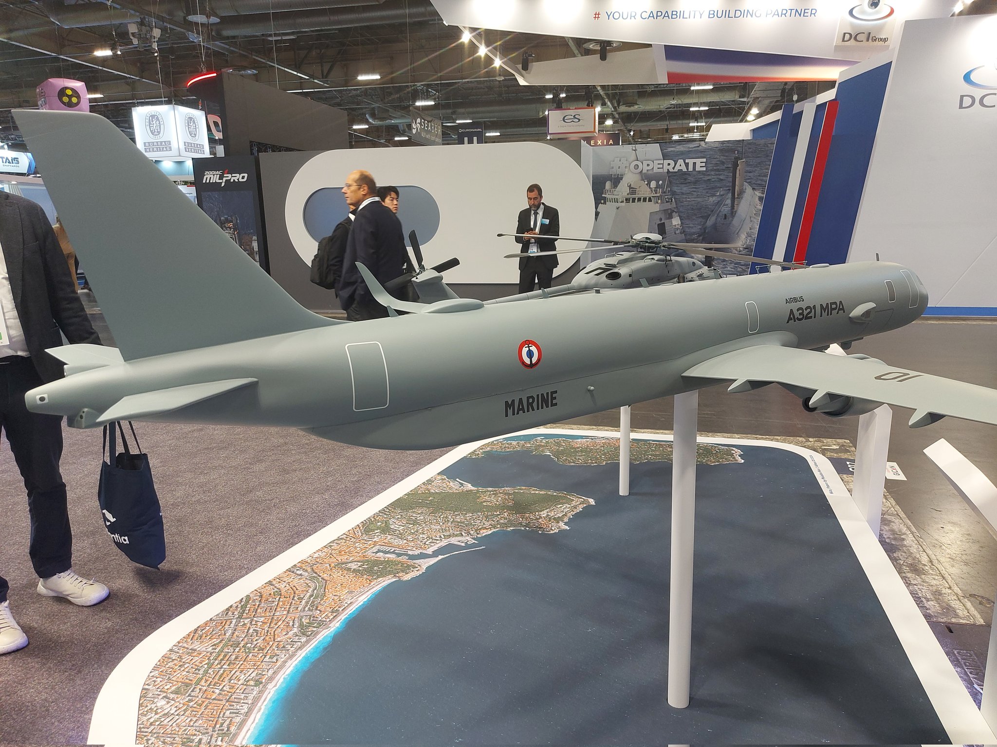

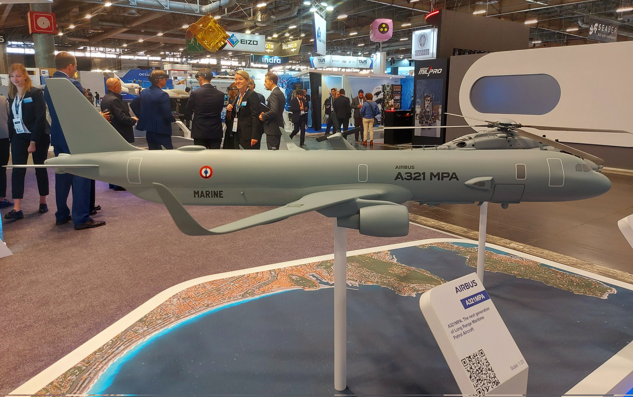

Airbus Proposes A321XLR Airframe For Maritime Patrol Mission
Airbus has matured its concept for a maritime patrol aircraft based on its A320 narrowbody product line with proposals for a platform based on the newest member of the family, the proposed A321XLR.
Presenting a model of the proposed aircraft at the Euronaval defense exhibition in Paris, held Nov. 4-7, Airbus says the selection of the A321 airframe with its longer fuselage will enable a larger payload bay to be fitted behind the wing than would have been possible on the shorter A320. Choosing the A321XLR, with its increased fuel capacity, also gives the aircraft more range and endurance, with the commercial A321XLR featuring a range of 4,700 nm.
Airbus has been developing the concept under an 18-month contract issued by the French defense materiel agency DGA in early 2023. Airbus was awarded one of two contracts. The other was given to Dassault Aviation to look at whether their selected platforms could be developed into an economically attractive replacement for France’s turboprop-powered Dassault Atlantique 2 aircraft.
Dassault has proposed a modified version of its Falcon 10X business jet.
A program to replace the Atlantique 2s could start in 2026, with entry into service in 2030-2040.
As well as an enlarged rear fuselage to accommodate a payload bay and sonobuoy launch systems, the proposed A321MPA features a series of sensors on the lower forward fuselage, including an electro-optical camera system. Large observation windows are fitted behind the cockpit, and blisters, likely for the fitment of electronic support measures, are fitted mid-fuselage forward of the engines. No magnetic anomaly detector appears to be fitted, as with the Boeing P-8 Poseidon.
France had previously partnered with Germany on the Maritime Airborne Warfare System (MAWS) program to develop an multimission platform for maritime patrol. France now considers that joint effort closed, after Berlin’s decision to buy the P-8.
https://aviationweek.com/defense/multi- ... ol-mission

Der A321XLR ist aber ein ganz schön heftiger Umbau. Reichweite / Ausdauer und Nutzlast müssen gewaltig sein im Vergleich zur Falcon 10X
Beiträge: 30560
Re: Frankreich: Studien für ein neues Seepatrouillenflugzeug
Ausgehend von den Basisdaten der Zivilversion wird das neue Patrouillenflugzeug möglicherweise auch leistungsfähiger als die amerikanische P-8 Poseidon:
Boeing 737-800 (P-8)
  • Länge: 39,5 m
  • Breite: 3,76 m
  • Spannweite: 35,8 m
  • Max. Abflugmasse (P-8): 85,820 kg
    • Boeing 737-800: 75 200 kg
  • Max. Treibstoffkapazität (P-8 - Quelle): ca. 34 0000 l
    • Boeing 737-800: 26 022 l
https://www.boeing.com/commercial/737ng ... al%20Specs
Airbus A321NEO-XLR
  • Länge: 44.51 m
  • Breite: 3,95 m
  • Max. Abflugmasse: 101 000 kg
  • Max. Treibstoffkapazität: 39 748 l
https://www.airbus.com/sites/g/files/jl ... 1_0322.pdf
